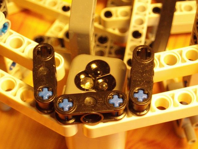

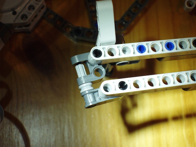

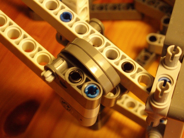

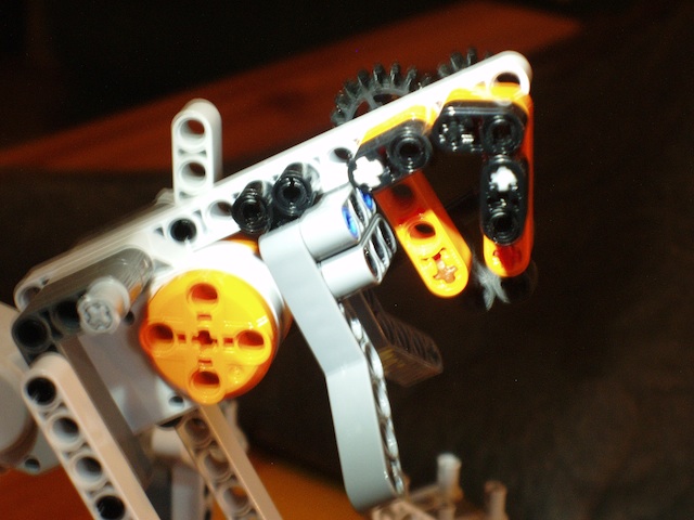

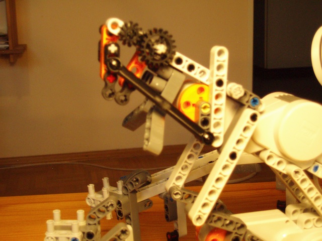

After much trial and even more error, I've finally come up with a set of almost useable photos:
This one shows the 3-beam added near the top of the arm alignment fork to stiffen it
The front side of the arm with the connector rod connected to a 3-beam instead of directly to the motor to allow for more clearance between the connecting rod and the rear finger. I also changed the back stop for the 3-beam from a small 2-beam to a 7-beam (I had run out of 5-beams). This gives better linearity when the fingers close on a ball.

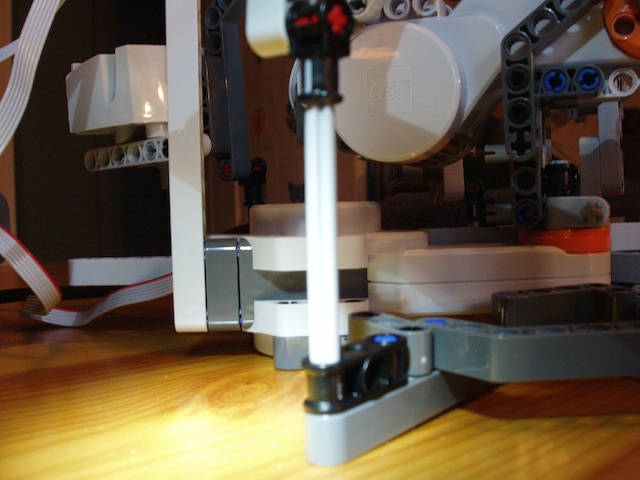

I'm including just one more photo to show that if given enough time, I can actually get one of these fully automatic digital cameras to focus on what I want.
It is a closeup of the light shield. The 3 black beams sit on top of beams that are suspended from the two stands on either side of the color sensor.
