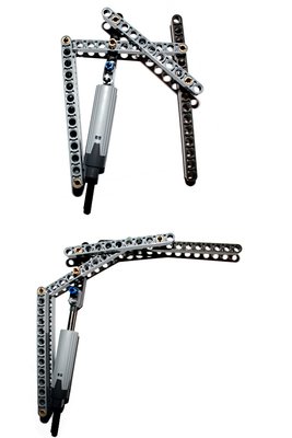

I don't use levers that much either so I'm not that experienced with them. Do you want two elbows in order to increase the range of the movement? I.e. something like this: I have never done anything like this, I just made this up, but it seems to work.stryker001 wrote:While that's fine and all, I don't want the "elbow" motor (U/D) to be geared, but rather use a series of beams/levers, basically because I want two elbows rather than one.
It the double elbow the only reason to use levers? It is actually easier to do this with gears, just place the motor in between the two elbows and connect it to both.
Why do you need a double elbow btw?
I still think it is a better idea to use gears for the up/down movement. Gears will allow you a movement of 270 degrees easily (and even 360+ if you want to) while you can't get more than 180 degrees with levers. (Something like 120 is more realistic though, the double elbow linkage above only allowed for 90 degrees freedom for example.)

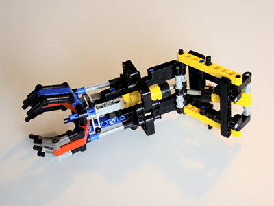

For the claw, I would advice trying to build it using one of those technic motors and controlling them with the HT sensor because they're way lighter than the NXT ones so you'll be able to use less gears. Here's a simple one I made a while ago:
Otherwise, I agree that pneumatics can also get the job done, but you won't have as much control over the outcome. If you want to do that using one motor (you usually need one for pumping and one for flipping the switch), it gets a bit more complex (you'd have to use a differential).
I did that and it worked really well:
If you only want to use one motor it's really important to keep your weight as low as possible to put less strain on your motors and speed the whole thing up a bit. One way to do that is by having all the motors at the base and then using gears and universal joints or levers to move the joints you want to use. You can't really see it in the picture below, but there's three motors down there; the middle one rotates the shoulder joint, the left one the elbow joint and the right one the wrist joint.
If you're interested, here's the article about the red one: http://dimastero.wordpress.com/2011/05/ ... -hardware/ and here's the article about the yellow/ black gripper: http://dimastero.wordpress.com/2011/06/ ... e-gripper/
One last thing: use counterweights wherever you can (like the anchor in the top picture)
