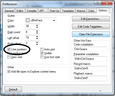

- i was reading the nxc tutorial and i see line numbers in the left hand side of the code
but when i use bricxx, there are no line numbers and when ever i have to use the go to line function, i have to manually count the lines!

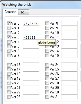

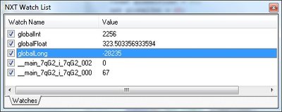

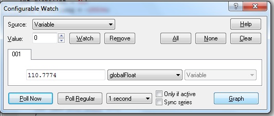

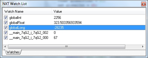

-and how do you watch variables? i was looked at the three methods and all of them are difficult to understand b/c the variable are named var1, var2 etc.

For line numbers, open 'Preferences', click on the 'Options' tab and click on the 'Line Numbers' box.

As Matt mentioned, you can turn on line numbers in the gutter via the Preferences dialog on the Options tab.
Choose the &quot;Line numbers&quot; option on the Options tab to turn on line numbers in the gutter.
Choose the "Line numbers" option on the Options tab to turn on line numbers in the gutter.

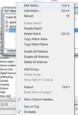

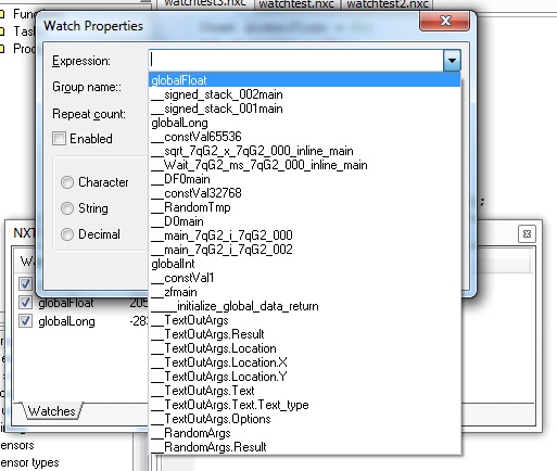

Re: I have a couple questions about NXC
All three of the variable watch tools name the variables something other than var1, var2, etc... Here are some screenshots.
hints on variable fields in the original watch window
The variable name shown on the configurable watch tool.
variables watches in the new NXT Watch List tool

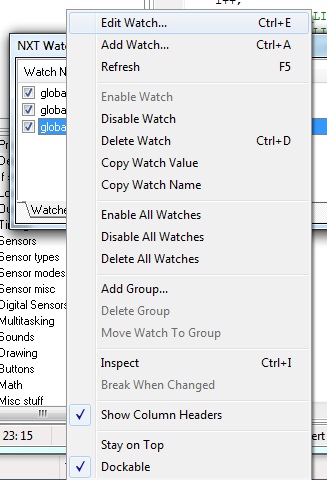

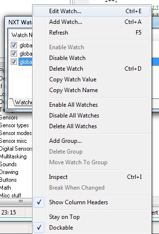

Watch list popup menu options
Watch properties dialog with drop down list of variables

I find the NXT watch list most convenient
however, i cannot find the variable i want to watch in the drop down expression list.
what if i just type the variable in the expression space; will it work??
thanks,
