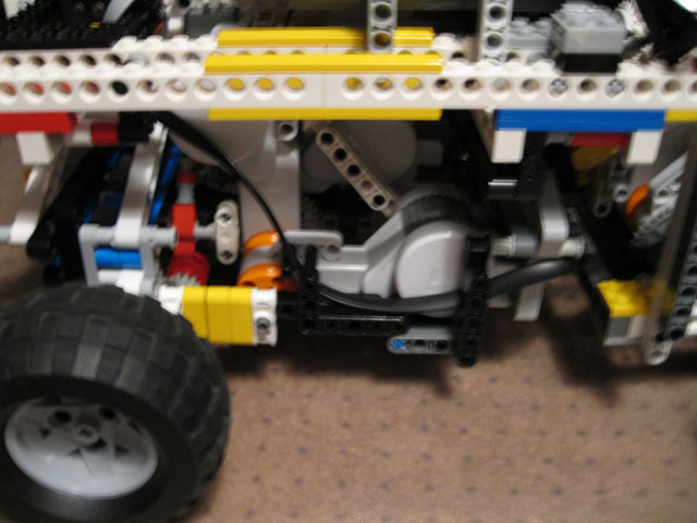

Here are some pictures of it: The front assembly: Note, there is a 3 attachment limit per post, so I plan to make another post (or two) for some more pictures.

Here is a picture of the rear gearing, and differential locking driving ring.
Here is a picture of the front gearing, and the differential locking driving ring. Here is a picture of the back, showing the rear differential locking mechanism the motor uses to lock/unlock the differential.Matt
