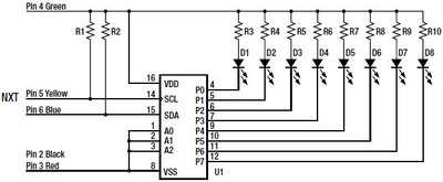

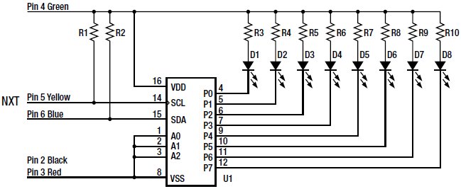

Hi everyone,
I'm trying to control 8 leds using a PCF8574 according to the scheme as seen in the attachment (from the book NXT Extreme).
The problem is that I can't control the leds. If I connect the PCF to the NXT only 4 leds are turned on continously (the leds connected to P0, P1, P2 and P3) and the other 4 leds are all off. I tried multiple software programs like NXT-G or NXC but I can't switch any leds on or off. It also doesn't matter which port I use (sensor port 1 to 4 or motor port A, B, or C) while I only programmed to control the PCF by sensor port 1.
Can anyone tell me what I'm doing wrong?
Greetings,
Brandts
Greetings,
Brandts

}Re: Need help with PCF8574
I'm dry... what bothers me most is the 4 LEDs continuously on. Are you sure your IC is not fried?
As for the NBC/NXC discussion, first edition of Extreme NXTused NBC as NXC was not yet available. But sample code were rewritten into (more palatable) NXC for the second edition.
