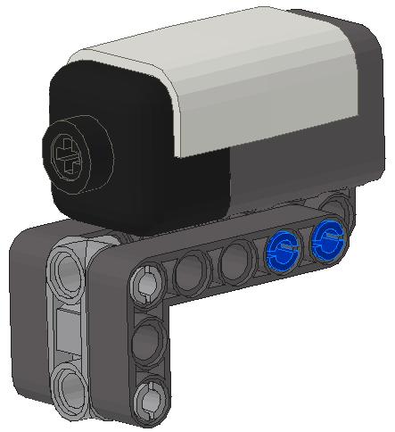

Re: New from HiTechnic: Angle and Magnetic Sensors
I also find the angle sensor package not very easy to use. It would be easier if axle hole was aligned with montage holes. Power functions mounting are really good for example.
On pictures, it looks like the axle hole is not aligned on the sensor center is it right?
Do you use an optic or magnetic encoder?

The sensor packaging is really not bad or difficult to work with. The axle hole is centered on the end cap which is exactly two units higher than the level of mounting holes on the bottom of the sensor.
Here is one simple way to get mounting holes lined up with the input axle: I understand the desire for a through hole but that would not work given the internal design of the sensor without adding significant cost to the design and production. The sensor uses, to answer another question, a magnetic encoder. The magnet portion of the encoder is mounted directly on the end of the axle shaft, deep within the sensor. A through hole design would not work with this encoder unless a complicated gearing mechanism was used. Something like that would add cost and potential for gear slop.
Regarding the calibrated zero position, what gets saved in EEPROM is the position of the encoder that is defined as zero. Once calibrated, the zero position of the axle will be in the same place even if you turn the axle when it is not powered. So there is no problem turning the axle and somehow loosing the calibration. In other words, if the Angle sensor is currently giving you 90 degrees, you turn it off (unplug it even) turn it 10 more degrees, turn it back on, and you will get 100 degrees from the sensor.
It is actually very interesting how this encoder works. The axle shaft basically has a magnet at the end. The sensor element, positioned just beyond the end of the shaft, is a two axis magnetometer. The angle of the magnet gets split into two component vectors and then the sensor performs essentially an atan2 function to calculate the angle.
One additional note regarding the use of a magnetic encoder... if you are also using a Compass sensor, make sure it is mounted well away from the Angle sensor... otherwise you more likely to pick up the position of the axle then the angle to the North pole.
Hope this answers the questions posted so far.
Gus

Looks nice as well, the ability to have the axle through would have beeen nice but as you state its not that hard to "hang it" under the axle and gear too and if it keeps the cost down that is a HUGE pluss.

yes, an "axle through" design (like the old rcx rotation sensor) would have been much easier to use.
(plus some extra mounting holes around the input hole in the middle....)
