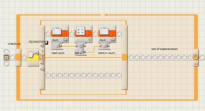

What I'm trying to do is this:
while (true)
if (condition)
counter++
[rest of implimentation]
The problem I am having is putting the added value back into the same variable that is being read. I might not be explaining it well, but I hope you understand what I am trying to get at. Thanks again for the help.

You have to set the block to write, so that there is an input wire.

NXT-G has a useful little "Help section". You may want to read about Data Wires (which work like parameters), Variable blocks, Conditional blocks (whatever they're called), and Compare blocks. These blocks can be found in the "Data Block" or "Advanced Block" sections.

Something like this?
You will need to edit the "Switch" (read: if statement)
to reflect your custom condition and add your code ;)
The math block does not write to the variable straight away, but stores it in a "data wire" (read: temporary variable)
which is used by the second variable block, that writes to the variable
program.zip
