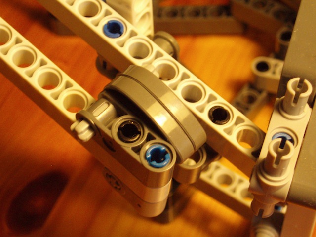

This one shows the 3-beam added near the top of the arm alignment fork to stiffen it
3-beam added to top of arm alignment fork

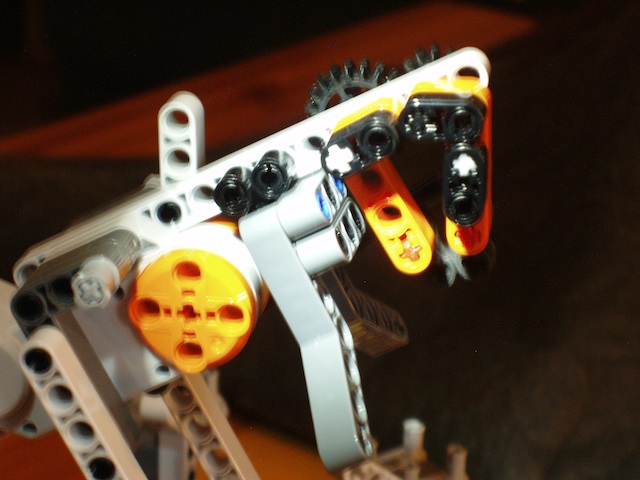

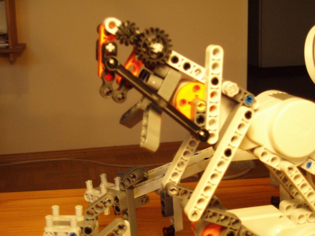

The front side of the arm with the connector rod connected to a 3-beam instead of directly to the motor to allow for more clearance between the connecting rod and the rear finger. I also changed the back stop for the 3-beam from a small 2-beam to a 7-beam (I had run out of 5-beams). This gives better linearity when the fingers close on a ball.

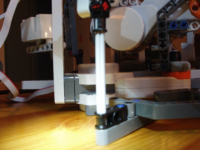

I'm including just one more photo to show that if given enough time, I can actually get one of these fully automatic digital cameras to focus on what I want.

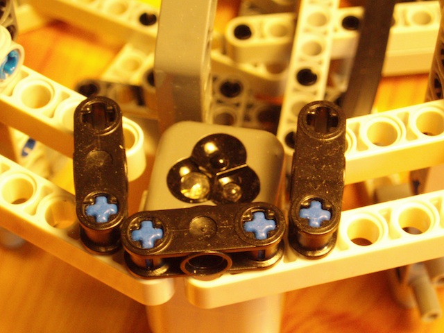

It is a closeup of the light shield. The 3 black beams sit on top of beams that are suspended from the two stands on either side of the color sensor.

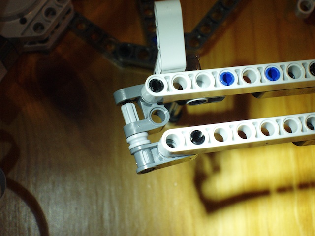

I connected the rails together with the following construction which allowed me to easily adjust the rail spacing. If the spacing is too narrow, the balls tend to fall off, if it's too large, they get stuck.
I also moved the top of the rail in 1 hole. At higher speeds, the balls tended to bounce off the inner rail and jump over the outer rail.
