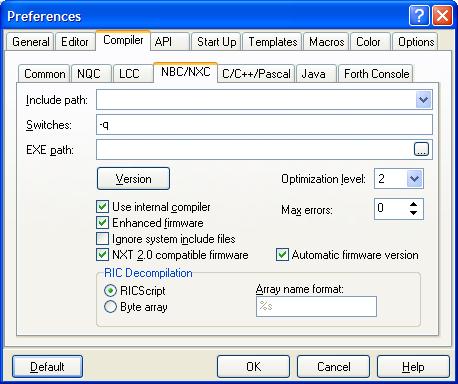

Do you have the compiler settings set to target the proper firmware?
Re: Programming the Lego Colour Sensor in NXC
In particular, to use any features of the 2.0 firmwares (i.e., version 1.27 or greater) such as the color sensor or support for floating point types you have to tell BricxCC to tell the compiler that it should allow code that requires one of the 2.0 firmware versions. As shown in the screenshot below you check the "NXT 2.0 compatible firmware" option in the Preferences dialog on the Compiler|NBC/NXC tab.

Thank you.
