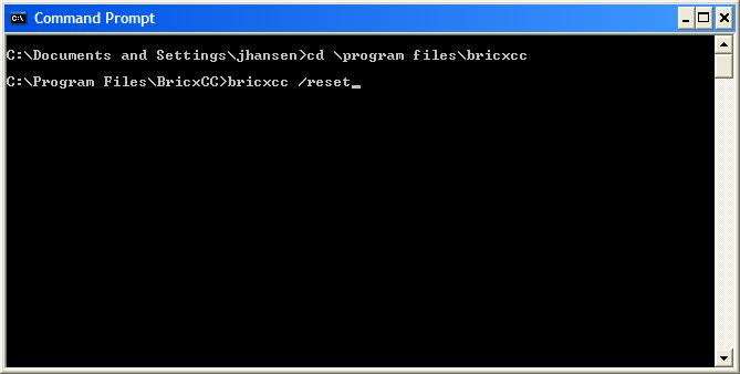

You can grab screenshots of what you are typing into the command prompt window. Can you post those? Use Alt+Print Screen and then paste into Paint and save as .jpg.
BricxCC should be in c:\program files\bricxcc - unless you are running a 64 bit OS (forgot about that). In that case it will be in c:\program files(x86)\bricxcc.

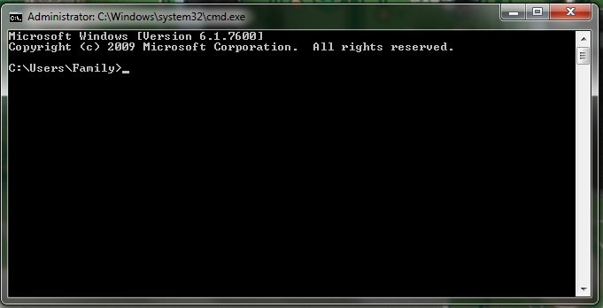

it is a 64 bit system, so you're right. Here is a picture of what it looks like before I type ANYTHING.
command prompt.jpg (34.22 KiB) Viewed 20050 times
Re: BricxCC HTML Help problems
Posted: 06 Oct 2010, 20:14
So did you type in the commands that I suggested? You would need to use the (x86) version of the program files folder name. I can't send you a file to fix the problem since the only way the current version of BricxCC will use Win32 help is if the UseHTMLHelp registry setting is set to false (0). The 3.3.8.8 version of BricxCC sets this to true by default while earlier versions set it to false by default. Older versions show a "Use HTML help" checkbox on the Options tab of the Preferences dialog so that you could switch from Win32 to HTML if you wanted to do so. The 3.3.8.8 release of BricxCC hides this checkbox so it is necessary to delete your BricxCC registry key or merge in a .reg file that sets UseHTMLHelp to true (1). Running bricxcc /reset will delete the BricxCC registry key.
