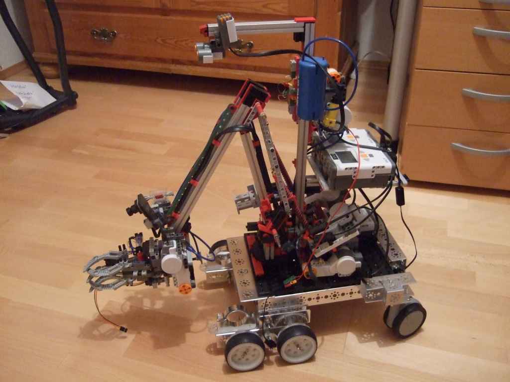

Dear Santa-John,
I firmly hope you're not stuck in the chimney anywhere, so please forgive me when I respectfully dare to kindly remind you of my Christmas present...of last year...?
I hope you still remember what I am referring to .... ?
If I'm not much mistaken, it might be rather far back in the Book of Christmas Wishes ... from last Christmas ... and it starts with a "T "....
Kind regards,
*cough*
D.H.
(!! INPUT !! - Johnny_7 needs action...)
