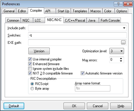

roscohead
Posts: 18
Joined: 29 Sep 2010, 03:09
Re: NXC: Tasks and global variables
Post by roscohead »
Yes, optimisation level was 2, and I don't use -q (NXT doesn't beep on successful download?). Those were the only differences.
So I experimented with different optimisation levels:
0: ArrayLen displays different number each time - always a multiple of 8.
1: Same as 0.
2: ArrayLen always displays zero.
3: Same as 2.
4: Same as 2.
5: Same as 2.
6: Same as 2.
All other compile options are identical, so there must be something else different here.
I also checked the NBC code (included below). One weird thing I noticed, in the print() routine, in section that prints out the ArrayLen(), there is the following:
	arrsize __D0print, __print_7qG2_vx_7qG2_000.a1
	mov __D0print, __DU0print
	numtostr __TextOutArgs.Text, __D0print
It seems to put the array len into _D0print, then overwrite it with a variable _DU0print if I'm reading it right? That seems wrong, and none of the other NumOut()s seem to do it. _DU0print is declared, but never initialised, hence why I get the zeroes, but why is it doing that assignment?
ROSCO
