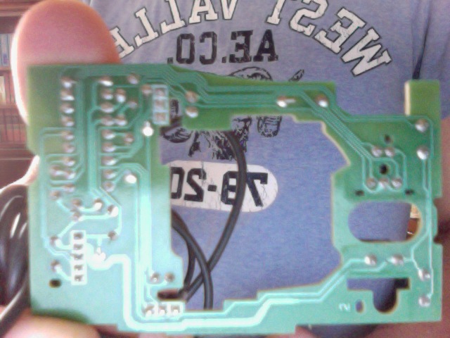

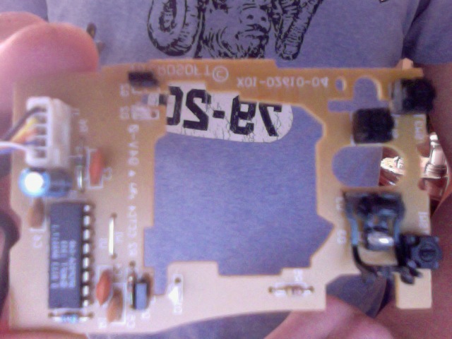

I'm salvaging an old microsoft mouse, and I need to know what parts I can save. I already know that I can easily use the three touch sensors on it, but i'm not sure what the other three sensors are, or if I can use them. It appears to be three LED's and three photoresistors. I have pictures of the top and flipside here:
Topside
Topside
Photo on 2010-10-29 at 15.49 #2.jpg (88.77 KiB) Viewed 11974 times
Flipside
Flipside
Photo on 2010-10-29 at 15.50 #2.jpg (97.03 KiB) Viewed 11974 times
The suspected LED's and photoresistors are on the corners of the large hole in the middle. Each suspected photoresistor has three ports and each suspected LED has two. So, are these photoresistors and LED's, and can I use them?
[img]Photo%20on%202010-10-29%20at%2015.49%20#2.jpg[/img]
[img]Photo%20on%202010-10-29%20at%2015.50%20#2.jpg[/img]

I have two Microsoft mice that look pretty similar to that one. I've taken one apart and left the other one together (for now). I'd take the IR LEDs and the photo-transistors (They're not photo-resistors. Photo-resistors react a lot slower, which means they're not practical for mice). There are also two caps on the board, get them as well. I actually almost always remove everything from a board when I'm parts harvesting. Even SM components. That way I can toss the boards or use them for something else. Motherboards are lovely things when it comes to parts. And you can always sell the core for a couple bucks.
-EDIT- Sorry, there are four caps on the board, not two :).

Your wondering what pins on the photo-transistor to hook up to what? Well, I'm not sure that you could actually use these too well with the NXT as it doesn't handle IR codes but as far as I figured it out the middle pin was the signal and the outer two where for +5V/Gnd. Don't remember exactly which was power, which was ground though... should be fairly easy to figure out with a breadboard, a transistor (2N3904 or similar), a couple resistors, one of the little IR LEDs you pulled off of the board and a little red LED. I'll work on figuring out which is which when I have time (in about a week :)).
