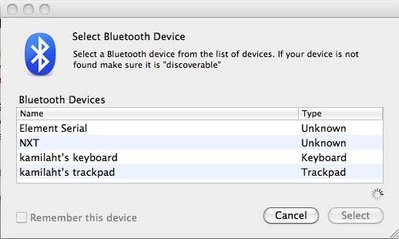

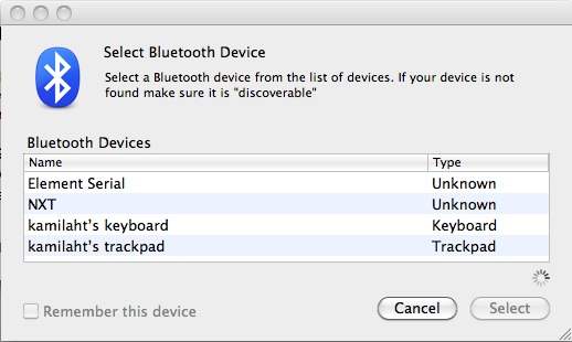

I have a strange problem. I'm using a mid 2010 Macbook Pro, Mac OSX 10.6.7, Snow Leopard. I can connect to the NXT over Bluetooth from NeXT Tools and from the Apple Bluetooth Explorer, but when I try to connect using the Fantom Library, I get the following dialog box:
The problem is I'm not able to select NXT, it just stays there with the Select button grayed out. Has anyone had a similar experience? I called Lego tech support and they said it was because it's one of the new Macbooks with an incompatible bluetooth chipset, but after hanging up I realised that this doesn't make sense since NeXT Tools can connect...
Kami
Kami

I see the dialog box as well, but I can select the NXT on my Mac.lizard381 wrote:I have a strange problem. I'm using a mid 2010 Macbook Pro, Mac OSX 10.6.7, Snow Leopard. I can connect to the NXT over Bluetooth from NeXT Tools and from the Apple Bluetooth Explorer, but when I try to connect using the Fantom Library, I get the following dialog box: The problem is I'm not able to select NXT, it just stays there with the Select button grayed out. Has anyone had a similar experience? I called Lego tech support and they said it was because it's one of the new Macbooks with an incompatible bluetooth chipset, but after hanging up I realised that this doesn't make sense since NeXT Tools can connect...
Kami
Interestingly NeXT Tool does not bring up the dialog. I'm trying to understand why there is a difference.
You might want to check the Bluetooth connection pairing is done correctly. There should be a serial port with Dev-B Modem Service serial port configured.
Re: Bluetooth connectivity problems NXT to Mac OS X
I've checked, I do have that setting configured. I would also like to know why NeXT Tool does not bring up the dialog. What model do you have for your Mac (year,make) and what version of OSX?tcwan wrote:I see the dialog box as well, but I can select the NXT on my Mac.

I'm using a 17" White iMac (iMac5,2), OS X 10.6.7. I have no idea why NeXT Tool behaves differently, it is not apparent from reading the source code (granted I'm not so familiar with Pascal anymore, but the function called are what's important).lizard381 wrote:I've checked, I do have that setting configured. I would also like to know why NeXT Tool does not bring up the dialog. What model do you have for your Mac (year,make) and what version of OSX?tcwan wrote:I see the dialog box as well, but I can select the NXT on my Mac.
Edit: I should add that it didn't come with built-in Bluetooth. I'm using an external BT Dongle (CSR), though it shouldn't matter since I can also select the NXT from my MacBook Air with internal Broadcom BT.
