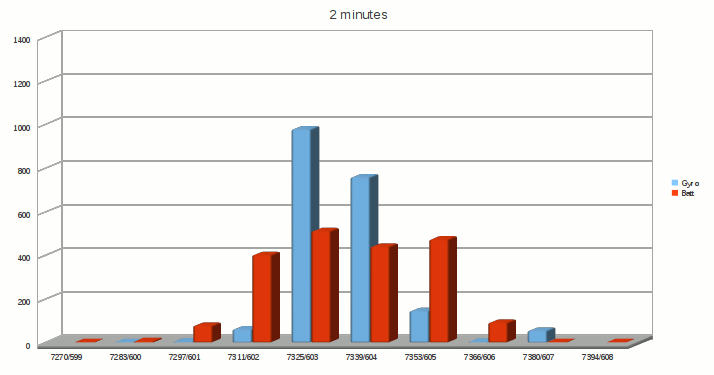

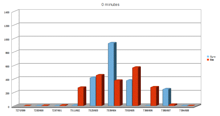

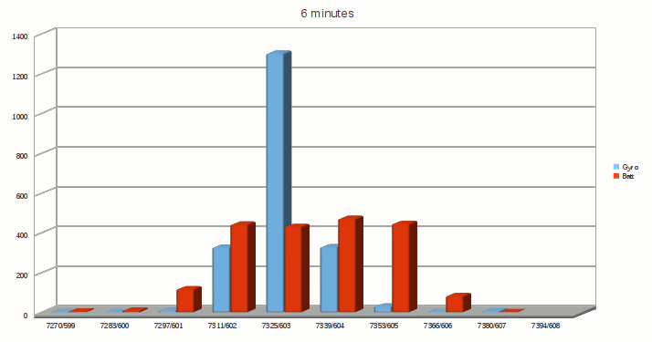

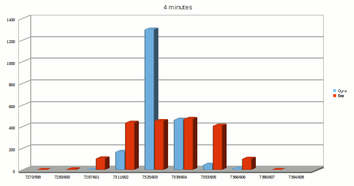

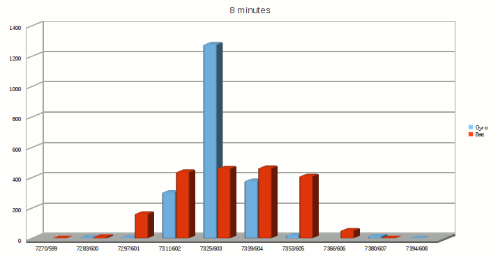

The sensor is an analog sensor, returning values from 0..1023 (10 bit AD). A motionless sensor usually returns a value around 600 (its offset value), but that can change depending on battery voltage and temperature, and it varies from sensor to sensor. Clockwise rotation returns a larger value and vise versa. If the sensor offset is 610, and the value returned is 600, the sensor is currently rotating at a rate of 10 degrees/s counter clock-wise.
Several issues are involved for reading accurate values: The sensor is a bit noisy, and the offset is constantly moving a bit up and down. Except for the noise, the sensor appears to be quite accurate.

Doc You may also find that the offset changes over time (due to battery voltage and temperature effects). When I played around with this I found that the offset would change a fair bit when you first start to use the sensor (I think this may possibly be to self heating effects). It then seems to settle down but voltage drop can also impact it.
