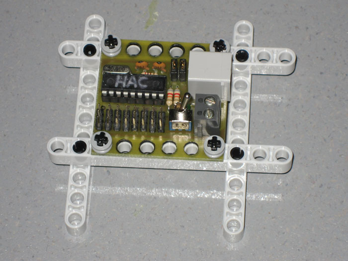

Hi there,
I'm a big fan of the Lego Mindstorms kit, and decided to make my own servo controller because the Mindsensors servocontroller is to expensive for my budget.
It works by using the I2C signal from the Lego brick, and the I2C write block from Mindsensors.
I can't select the servo speed, but I can adjust to speed by inserting a delay time in the program, so It's not as sophisticated as the Mindsensors servo controller, but it does the job...
I would like to hear what you think of it, so please take a look at it, on my website.
http://www.hacsoftwarecompany.com/?proj ... _nxt_servo
Many thanks !!

Nice sensor! What controller did you use to control the servos?
Re: My selfmade servo controller
I used a PIC Microcontroller, type 16F819. This had it's own I2C communication, so it's easy to attach this to the Lego brick. And the PIC microcontroller also can produce a standard servo output signal. Not that difficult to make, and quite cheap. It cost me about 20 euro's in parts.
Very cool , but what a coincidence ! I was just about to post about a servo controller I made (though not nearly an nice)! Thanks for sharing. It looks really great!

Indeed a coincidence...
I must say that I'm a bit of a perfectionist, so I made a PCB for my project, but yours is great too. And as long as it works, it's cool in my book !

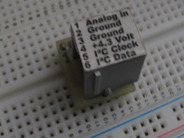

Well, I'd LOVE to be able to make PCB's, but I am not really sure how to design them yet.
BTW, you of all people should understand what I want. I want a breakout for the mindsensors NXT jacks. I want them broken out to 0.1" holes. I could then solder either a header, or wires to it. It would be great for breadboarding and custom sensors (with perfboard). I have no idea how to accomplish something like this, so I asked mindsensors to consider making it. I haven't gotten a response, so they probably didn't like the idea. What would it cost to develop something like that, and have the PCB's made? They would be tiny PCB's (about 2x2 cm). I love soldering, so I would just need bare PCBs. I could probably use 10 or so to begin with.

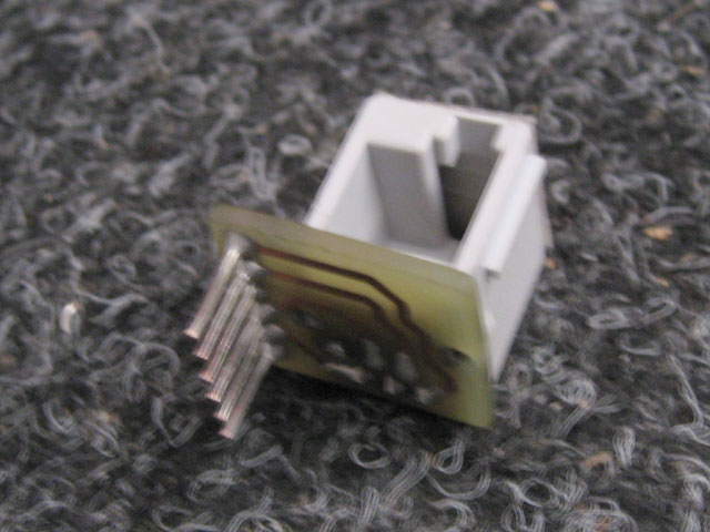

I actualy made a breakout jack for the NXT. You can order the NXT jacks from Mindsensors. Sorry, the photo's are a bit blurry... I dropped my camera and now it can't focus anymoremattallen37 wrote: I want a breakout for the mindsensors NXT jacks.
If you can't make PCB's, you can just solder wires to the jacks and put then into your breadboard.

That is basically exactly what I mean/want. The only thing I might want different, is for the jack to be turned 90 degrees.
Yes, I know I can buy them from mindsensors, but I want a breakout (like yours), instead of soldering wires directly.
Currently, I am using a wire cut in half, broken out to a 6 pin header.
