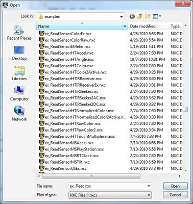

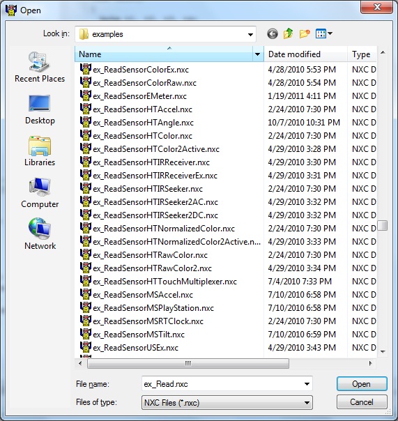

Re: NXC: HT TouchMux Sensor gives faulty readings
The program works perfectly with my HT Touch Multiplexer and 4 NXT touch sensors. And like every single HiTechnic and Mindsensors.com 3rd party device API function that returns more than one value it is named starting with ReadSensor then 2 characters for HT or MS and then the type of sensor data being returned.
Perhaps you forgot to change the port number if you had your mux attached to a port other than S1?
