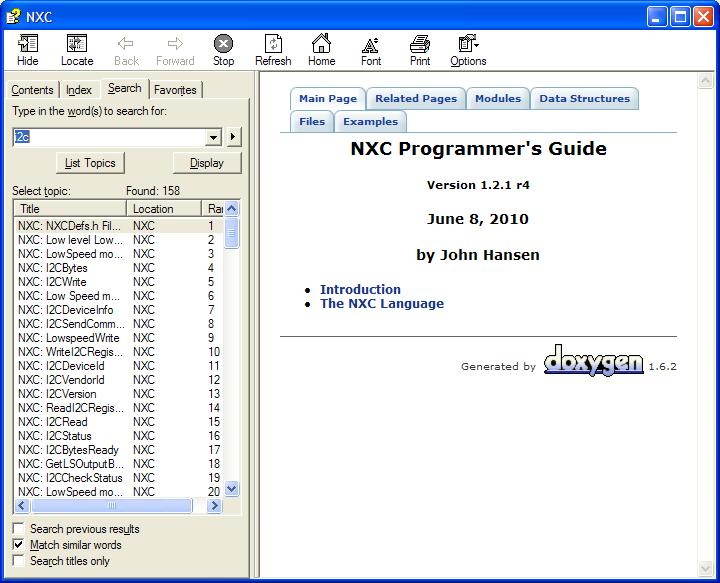

This is really hard to do but I double clicked on the NXC.chm help file that comes with BricxCC and typed "i2c" into the Search field and pressed enter. See what I got:
A number of I2C functions are under the HiTechniic and Mindsensors API sections, though they are not generic I2C functions.

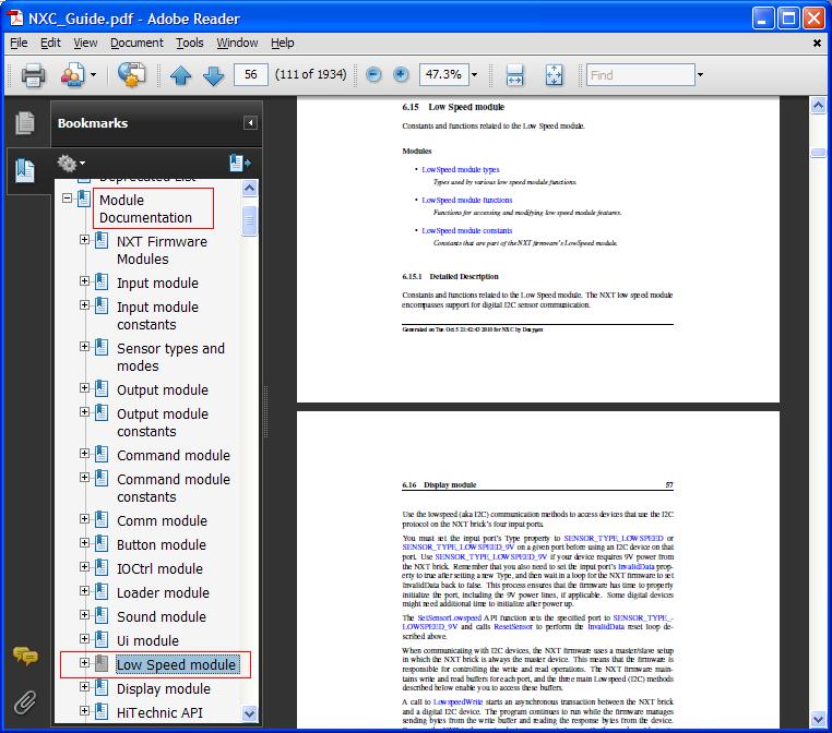

I don't know whether you are saying that the help, guide, and tutorial need a chapter called "I²C" or whether you are saying that you could not reproduce the search results that I posted above. I hope you aren't using a special ASCII character for the number 2. Did you try double clicking on nxc.chm and typing i2c into the search box and press enter? As you should know, the NXT firmware has a module called LowSpeed which implements all of the I2C support in the firmware. You could try searching for "lowspeed" or "low speed" in the nxc.chm file and see what comes up.
In the NXC_Guide.pdf you can expand the tree on the left at the Module Documentation folder and see the Low Speed Module link.
You can also search the PDF using Acrobat Reader for "i2c" or "lowspeed" or "low speed" and find lots of information - poorly structured by some opinions.
