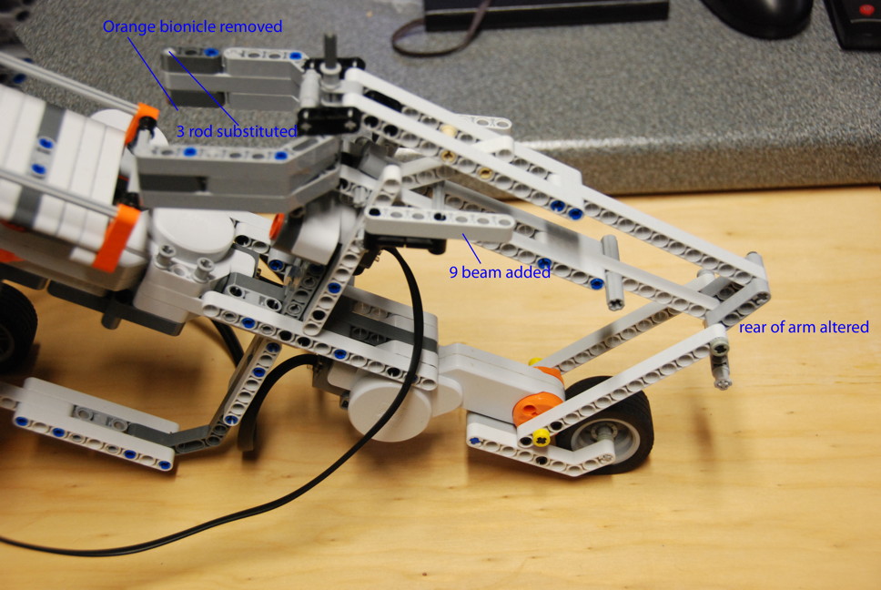

The other areas I have played with on and off for a long time is in trying to get Hans Andersson's tiltedtwister to work. There were some quite large threads on this on the nxtasy site. I have recently had quite a lot of success with the latest tiltedtwister 2.0 version which is designed on the NXT 2 set. Hans has updated the software, and I find that this now works reliably as far as reading the cube is concerned. I have experimented with altering the design of the arm a bit, largely after viewing the video shown here http://www.youtube.com/watch?v=rvAjDHOTiHQ
The author has removed the orange Technic Bionicle 1 x 3 Tooth with Axlehole, has added 7 hole beams to stop the Technic Angle Connector #6 just behind the ultrasound sensor from coming apart, and appears to have altered the positioning of the two Technic Beam 4 x 4 Liftarm Bent 53.5 at the end of the arm assembly.
I now have an arm which will solve slightly disarranged cubes, but it still has problems when the cube sticks and doesn't align properly after some twists. I am experimenting with lubrication, and also am trying to hack the program to add a pause (until an added touch sensor is pushed) each time the cube is released by the arm, so that any manual tweeks can be made. Has anyone else done this?

Below is an annotated image of my modified twister arm, based on fsalimen's youtube video. (twister225.jpg)
I have now also modified the program code so that it pauses each time a layer of the cube has been rotated, so that it can be manually adjusted if it is not completely square. Using this, I can now successfully solve any scrambled cube on my arm. I will now work on lubricating the cube, to try and get it to solve without manual intervention.

With these alterations you plub a touch sensor into port 4, and each time the cube is released after it has had a layer twisted, you can adjust it manually if needed, and then push the sensor to allow the program to continue.
