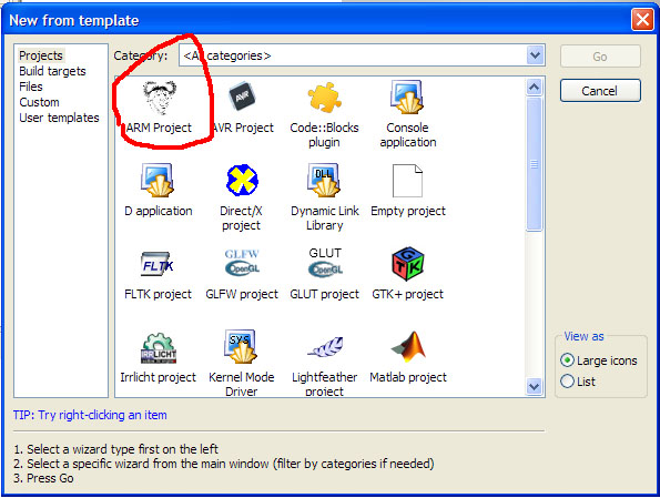

I know you can create an ARM project in Code::Blocks, with gcc
Maybe if would work better with IAR embedded Workbench (free 128kb limited version, for the nxt), which the Lego devs used
