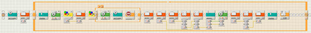

Hello friends, somebody can help my with LEGO mindstorms nxt 2.0? i have a color sorter and programm in LEGO MINDSTORM soft... but i need make this program in brix... i dont know how i can save starting motor angle and then tur it in position, what i need... i can sand to e-mail program .rbt file, sombody can help make it in BRICX?

You want to convert this NXT-G "code" to NXC?

yes, i want convert this project to BricxCC (.nxc) code

i need this programm in BRICX, because i write work about two robots, one robot is programmed in bricxx but othet in LEGO software... i want other robot programm get in BRICX code... i need it very much...
