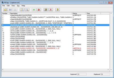

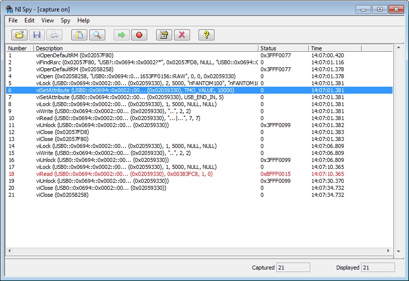

Re: NXT access via USB on OSX
I did some digging and was able to determine that the Fantom drivers call viSetAttribute to set the TMO_VALUE of the current session to 10 seconds as part of the process of opening the USB connection to the NXT (in iNXTIterator_getNXT or createNXT). The subsequent call to viRead, when no data is available, will block until that timeout value expires and then return 0xBFFF0015 (VI_ERROR_TMO) - "Timeout expired before operation completed" - which in Fantom is converted to 0xBFFF003E (VI_ERROR_IO).
I'm looking into whether it is possible to call viSetAttribute after opening the connection using the Fantom drivers and set the timeout to a much lower value.
