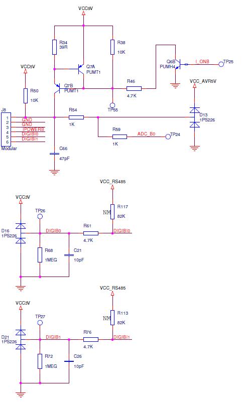

I looked in the hardware schematic and found the part that deals with the data lines. See the image below, don't forget to scroll down. Does this mean they run at 3.3V? (The fact that I can read a schematic does not mean I can understand itnxtreme wrote:Don't the data lines run at 3.3V logic? Or am I mistaken? I do remember that somebody on the NXTasy forums said that when interfacing with 3.3V sensors you could just substitute a 47K pullup for the 82K and connect the data lines directly. Maybe I'm mis-remembering something...

So really, aswin wouldn't really need the logic level shifters, right? I like to keep designs as simple as possible, maybe its showing now

-EDIT- You can also click on the picture to make it expand to it's full dimensions... and thanks for the picture, aswin! I have looked at the HDK before but it always seems to vanish when I do hard drive spring cleaning. Note to self: download HDK again
