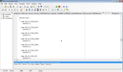

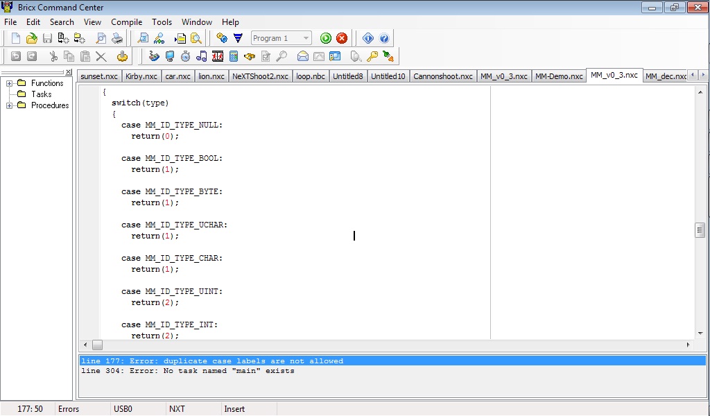

There is an error saying "duplicate case labels are not allowed" on line 177.
Here's a pic:
Thanks, and have a nice day,
nxtboy III
programnxt.com

@nxtboyiii Thanks for that bug fix.
The fixed code is attached.
MM_v0_3.zip
(3.02 KiB) Downloaded 653 times
