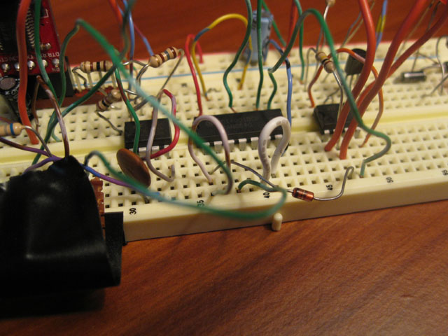

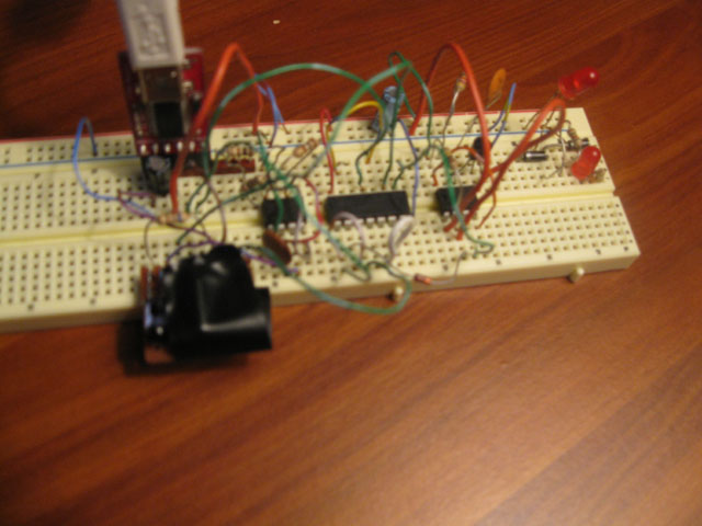

Ever since the beginning of my RCX collection, I have always programmed them with a Win98 computer. I like the stability and simplicity of Win98, but it has always been frustrating to not have internet on it, even though it sits right beside the main computer. One example of something I would wish to do, was copy a piece of code off of the internet, and paste it into the program I was building. In order to transfer files, I have to use a flash drive, and that gets annoying (and time consuming). So for a while now, I have obviously been wanting to program my RCX's with our Win7 computer. The problem was, there are no 64-bit drivers for the lego USB tower, and our computer doesn't have an RS-232 port. I know you can get USB to RS-232 adapters, but to get one guaranteed to work on a 64-bit system, you usually have to pay almost $20 US. I did however find and buy one that is guaranteed to work, for only about $3 US, but we'll see if it holds up to the sellers claim. It probably won't get here for a couple weeks or so, and I am just itching to program the RCX's with this computer. So in the meantime, I built a "tower" based on a SparkFun FTDI (yes, the 3.3v one, not 5v). It took me 13 or so hours to build/test/rebuild..., and now it works :D
It took a lot of trial and error to get this to work. The first step was changing the FTDI COM port from the assigned 13 (or whatever it was) to a number that I can select in BCC. I decided to go with COM 2. Several of the concepts I used were based off of the Lego serial IR tower schematic; however, there is plenty of my own design in it. The only electronic tools I used, were an LED, and a serial terminal program on the computer (I may have used a multimeter once or twice). It sure would have been nice to have a scope or logic analyzer, but since I have neither, I did without. One problem I had, was getting "bad" messages because the TSOP was being over-saturated. Normally, you can just move the RCX back a little, and it's good to go, but the IR LED isn't being driven strong enough to have the RCX more than a few inches away. That is why I decided to put tape on the TSOP. It now works well within a few inches.
Some information:
LED must modulate at 38kHz when transmitting (solved using a 555).
The LED must be on for a 0 and off for a 1 (idle "1"). To invert the logic, I was using a 4049 (hex-inverter), but I needed a gate with two inputs (explained later), so I traded it for a 4001(NOR). The 4001 also provides the current for the IR LED, so the FTDI tx pin doesn't have to.
The TSOP signal MUST be disabled (not allowed to reach the FTDI rx pin) while transmitting (and for a very short time after). If it is able to receive, it would be like tying rx to tx in a half-duplex system (while transmitting). The IR from transmitting would go straight to the TSOP, and right into the rx buffer; NOT GOOD! I used a 555 in Monostable mode for timing to avoid this. Note, I had to add a transistor to drain the cap (thus resetting the timer), whenever it sent another 0 (LED on). I fed the 555 output and the TSOP output into one of the NOR gates, so only if both were low (not transmitting, and also receiving a signal), it would output a high. I then inverted the signal so it would be right (1 high, 0 low as according to TTL UART specs), and finally sent the signal to the rx pin on the FTDI.
Things with blinky lights are always better 8-) The TFDI board has blinkies for both tx AND rx :geek:
This is one of my first projects using IR or UART (at this level), and it seems to work really well now. I am impressed (with this somewhat pointless project) to say the least :ugeek:
Oh, and I didn't let any magic blue smoke out of the parts in the making of this :lol:
Things to do:
  • Rewire it.
    Replace the two 555's with a 556.
    Try to get a better 38kHz duty cycle (I think it is around either 43% or 57% now).
    Try to get better tx range (a better duty cycle should help).
    Try to make the rx disable more efficient/faster.
    Possibly solder it onto a perfboard.
    Last, but certainly not least, draw the schematic.
Feel free to ask questions and make suggestions.

Guess what!!! I realized that I forgot to add the diode to the astable 555 circuit. As a result, I was getting about 25.8 kHz instead of 38 kHz. That could be a big part of why it had such short range :) I am working on rebuilding the circuit, and plan to use the diode this time ;) Hopefully I will be able to get better range.
Re: RCX FTDI IR "Tower"
Okay, so I rebuilt the entire thing, and remembered the diode this time. I also added a 2n2222 transistor for the LED. The other side, cathode, is driven by the 556, and obviously should be fine, as I think it can sink 200ma. I also took off the tape I had put on. I got great results :D
When the RCX is in short range, it is the limiting factor. It allows for up to somewhere around 60-70cm range (pointing directly at each other).
When the RCX is in long range, the IR "tower" is the limiting factor; allowing up to about 1 meter.
I still haven't tried changing the voltage, or adding more LEDs. I haven't even tried squeezing the last bit of power out of the LED the way it is now.
