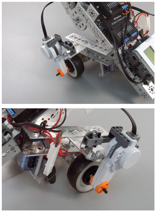

hi,
using the NXT motor passively driven just as an encoder is giving a high drive resistance
- anyway, the advantage doing this is having a very quick encoder without losing a sensor port for each motor encoder.
Has anyone tried to remove the motor out of the housing so that the encoder can be driven with a with a lower driving resistance?

Can't you use a non-NXT encoder? I know I have seen where someone did this. If it is for your tetrix stuff, those encoders should work I think. Do you know the precision? The only issues I foresee is that they could pulse too fast for the NXT to read, but I don't think that will be a problem, and the other, is that the ~4.3v might be too low (they are probably rated 5v). I am quite sure they are quadrature encoders, same as the NXT.

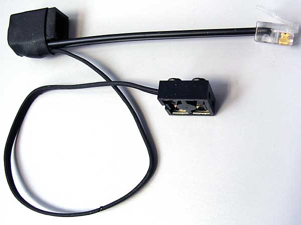

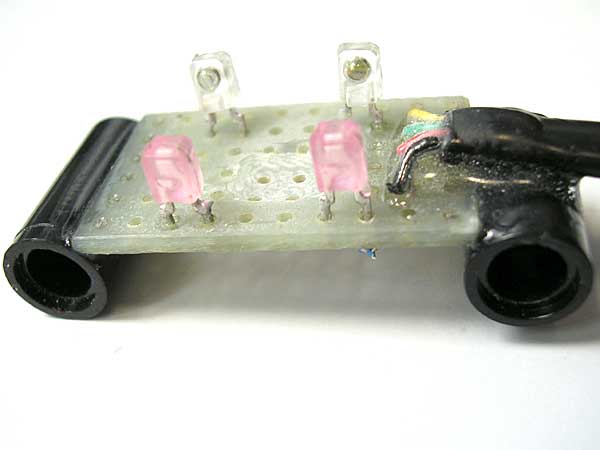

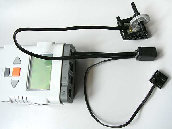

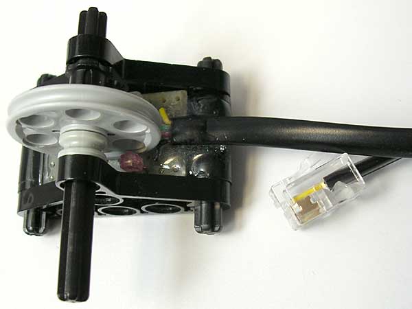

If you dare to do some electronics tinkering, here is an old attempt I did, that worked fairly well (but I never wrote up about it). It uses ball mouse encoder components and a LEGO wedge belt wheel. The schematics is more or less the same as NXT internal motor encoder. A Y split cable allows to use an unencoded motor at the same time as the encoder.

One drawback of this setting is that the open frame construction makes it somewhat sensitive to ambient light. The resolution is also limited, to 12 ticks per turn.
