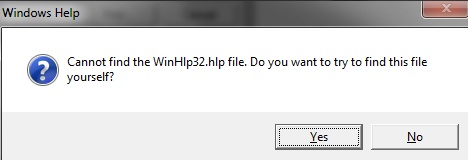

Starting very recently, this message has been popping up when I attempt to open help (from BCC).
BCC help error.jpg (17.34 KiB) Viewed 22794 times

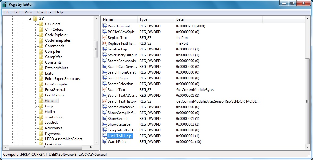

Sounds like UseHTMLHelp is false. The only way that can happen is if UseHTMLHelp is 0 in the registry. It that value isn't in the registry at all then with 3.3.8.8 UseHTMLHelp has to be true. Try this (carefully):
1. click Start
2. type "regedit" into the edit box right above the start button then press enter. OK the question about making changes to the computer.
3. expand HKEY_CURRENT_USER
4. expand Software
5. expand BricxCC
6. expand 3.3
7. select General
8. scroll to the bottom of the list on the right looking for UseHTMLHelp
(186.04 KiB) Downloaded 251 times
It seems certain that your registry has 0 for this value. You might also try searching the entire registry for UseHTMLHelp. In any case, you can just delete this value and it should be changed to 1 the next time you run BricxCC.

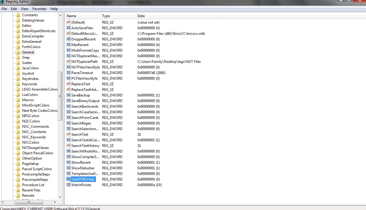

Re: Bricxcc and firmware test versions
Indeed, it is 0, as you say. So, I should just remove that, and BCC will replace it with the proper one?
Here is a picture of it.
(233.25 KiB) Downloaded 249 times
In theory you could delete it or you could double click on it and change the value to 1. But deleting that key is what the /reset was supposed to do and changing its value to 1 was what running that .reg file was supposed to do. Try both options (one at a time, of course) and see if either makes BricxCC start using HTML help. I'm just about at my wits end on this one.
