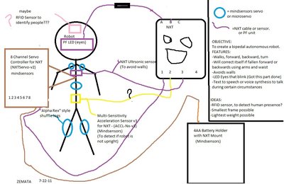

Total mindstorms noob here. Would love to learn more about programing and robotics in general. Only successful creation of mine so far is a contraption that plays Pokemon Emerald on a GBA SP lol. My current supplies include one NXT 2.0 set and a large collection of Lego and Technic.
So here's the deal. I want to make a humanoid, bipedal robot that can....
-Walk forwards, backwards, and turn
-right itself if toppled (using arms and waist swivel. Maybe leg movement too)
-avoids walls
-recognizes humans (MAYBE could I use a RFID sensor for this? If yes, could I combine the previous feature into this sensor?)
-Speaks and reacts with speech to different circumstances
-Light up eyes that blink (already have this part done using the PF LEDs on port A of my NXT. Programmed them to shut off for about 0.1 seconds intermittenly)
-maybe more.....
Parts I'd like to use externally (Not inside the robot, but connected via a grouped up "umbilical cable")...
1 NXT
1 4AA Battery holder
Parts I'd like to use internally...
5-6 Mindsensors microservos
1 set of PF lights
1 sensor to detect if robot is not upright (Don't know if I need a gyro, acceleration, or compass for this)
1 RFID Sensor OR 1 RFID sensor and Ultrasonic sensor
1 8 channel servo controller for NXT (mindsensors)

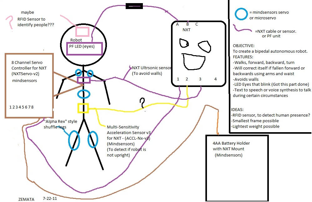

excuse the crude drawing
