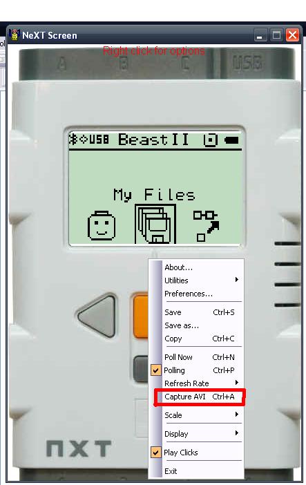

Can't you just use the Capture AVI feature in NXTScreen

What capture AVI feature?
