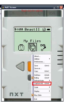

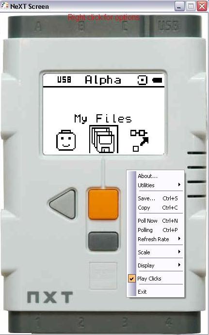

Can't you just use the Capture AVI feature in NXTScreen
What capture AVI feature?
