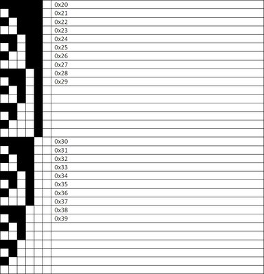

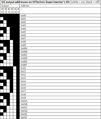

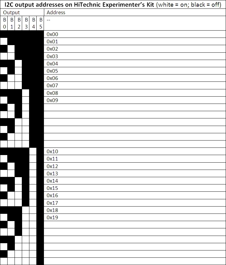

I recently got the HiTechnic Experimenter's Kit, and I've got it set up withsix LEDs connected to the output pins (B0 - B5) on a breadboard. i was trying to turn them on in different ways using one of the example programs, but I can't get some of the combinations, like turning the first four on, for example. So I wrote down all possible combinations, and tried to get them. Turns out I can't get 24 of them.
The attached images (they might also show up below, if everything works) show all the combinations I could think of, with the I2C addresses next to them, if I could find them. My question is (surprise surprise) if it's possible to achieve those other outputs and how?

Thank you for the quick reply! I was using RobotC for this (hitechnic experimenter's kit experiment two - i removed the last if elses and wrote the address just before the "write" command) and I don't have NXT-G on my computer. One more thing I forgot to mention is that the whole thing starts repeating once I hit 40 -- so 0x40 = 0x00, 0x41 = 0x01 -- and give the exact same results. Should I send HiTechnic an email?

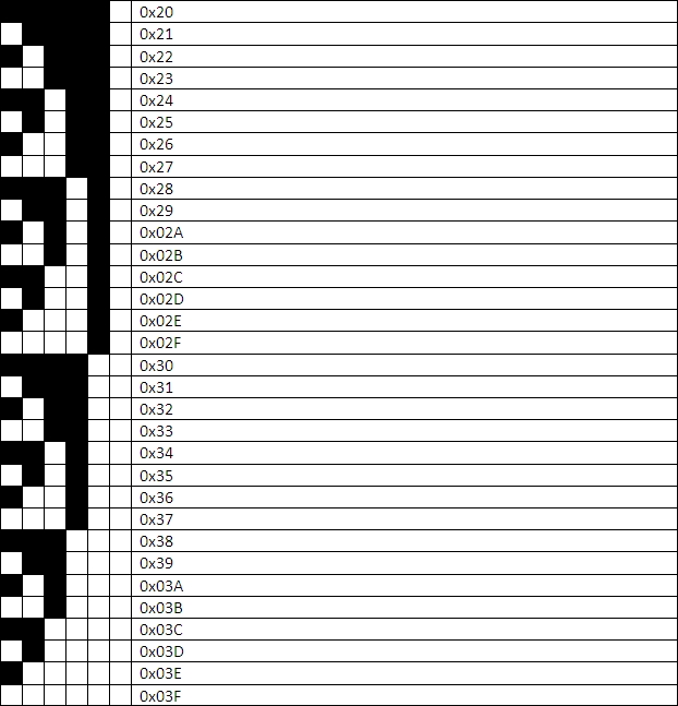

yep, that was the problem. Thank you! Address 0x00A, B, C, D, E, F got the first six, 0x01A, ..., F, got the second, 0x02A, ..., F got the third and 0x03A, ..., F got the last; they were even in order! I've got images of the new list attached below (can't paste the whole thing here because it's too long :/). If it's helpful for anyone, I can post a link to the full image.

@dimasterooo: 0x prefix means the number is a hexadecimal number. The possible values for each place are 0-F (instead of 0-9 for decimal). Your chart only uses 0-9, and no doubt that is your problem.

yeah that was the problem, I added them in the sheet above. Thank you anyways
