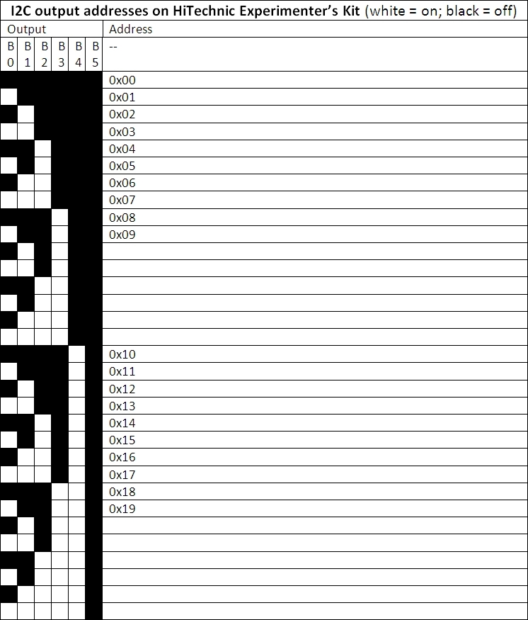

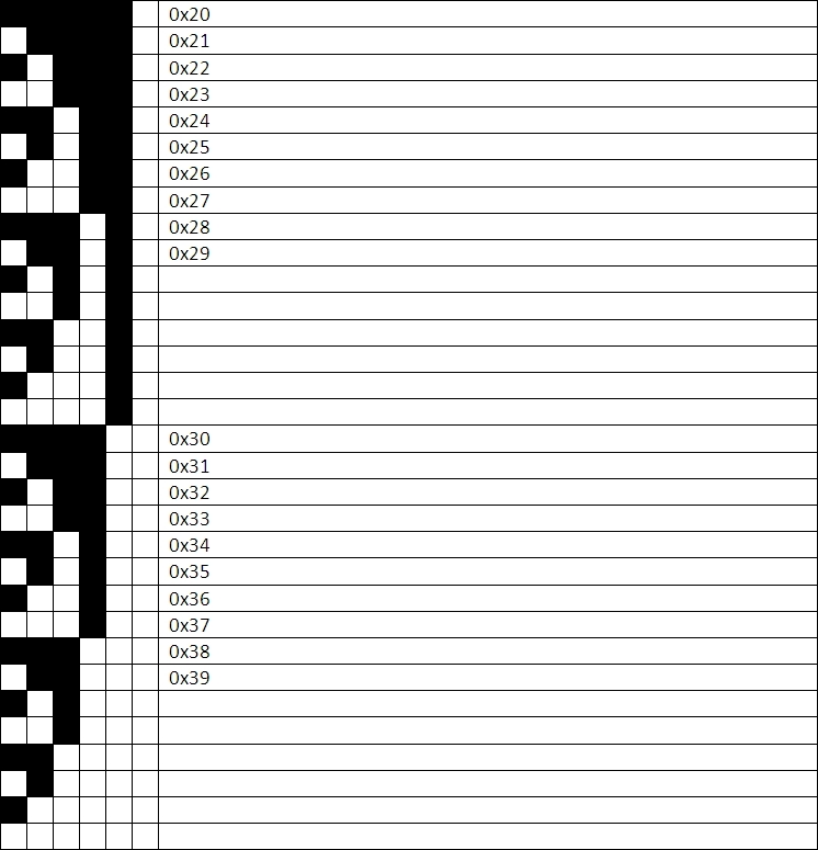

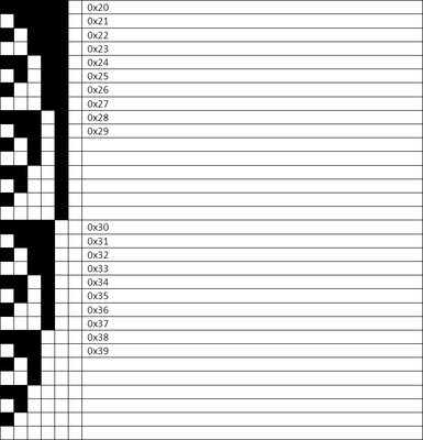

Hi there,
I recently got the HiTechnic Experimenter's Kit, and I've got it set up withsix LEDs connected to the output pins (B0 - B5) on a breadboard. i was trying to turn them on in different ways using one of the example programs, but I can't get some of the combinations, like turning the first four on, for example. So I wrote down all possible combinations, and tried to get them. Turns out I can't get 24 of them.
The attached images (they might also show up below, if everything works) show all the combinations I could think of, with the I2C addresses next to them, if I could find them. My question is (surprise surprise) if it's possible to achieve those other outputs and how?

Unless I am missing something obvious, the 'missing' values are 0x0A, 0x0B, 0x0C, ..., 0x0F and so on.dimasterooo wrote:Hi there,

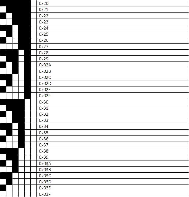

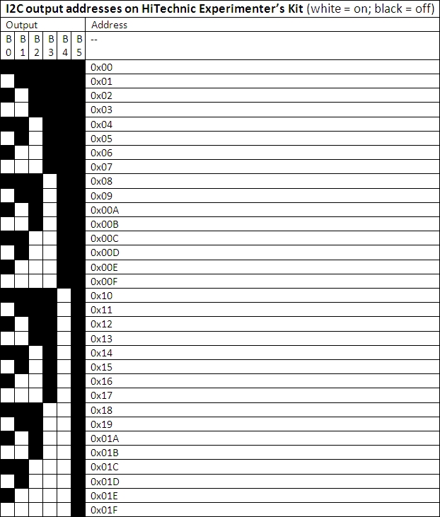

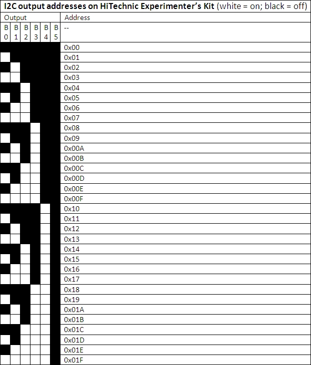

yep, that was the problem. Thank you! Address 0x00A, B, C, D, E, F got the first six, 0x01A, ..., F, got the second, 0x02A, ..., F got the third and 0x03A, ..., F got the last; they were even in order! I've got images of the new list attached below (can't paste the whole thing here because it's too long :/). If it's helpful for anyone, I can post a link to the full image.

Indeed, that is what it looks like.bullestock wrote:Unless I am missing something obvious, the 'missing' values are 0x0A, 0x0B, 0x0C, ..., 0x0F and so on.
@dimasterooo: 0x prefix means the number is a hexadecimal number. The possible values for each place are 0-F (instead of 0-9 for decimal). Your chart only uses 0-9, and no doubt that is your problem.

yeah that was the problem, I added them in the sheet above. Thank you anyways

Anyhow, you normally use exactly two digits to show a Hex number. For example, the interface can accept a range from 0x00 through 0x3f (not said 0x0 through 0x03f).
Hex is a number system, and number systems values don't magically change values.dimasterooo wrote:...they were even in order!...
