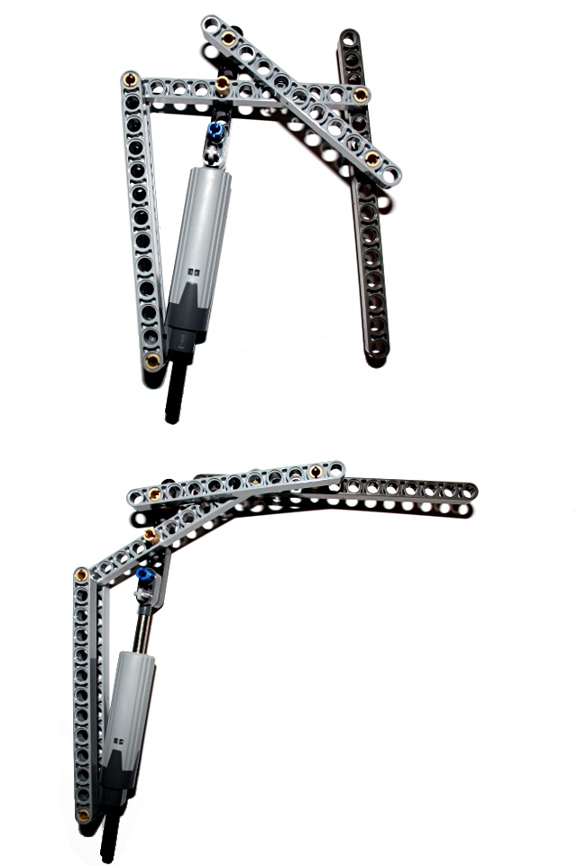

I don't use levers that much either so I'm not that experienced with them. Do you want two elbows in order to increase the range of the movement? I.e. something like this: I have never done anything like this, I just made this up, but it seems to work.stryker001 wrote:While that's fine and all, I don't want the "elbow" motor (U/D) to be geared, but rather use a series of beams/levers, basically because I want two elbows rather than one.
It the double elbow the only reason to use levers? It is actually easier to do this with gears, just place the motor in between the two elbows and connect it to both.
Why do you need a double elbow btw?
I still think it is a better idea to use gears for the up/down movement. Gears will allow you a movement of 270 degrees easily (and even 360+ if you want to) while you can't get more than 180 degrees with levers. (Something like 120 is more realistic though, the double elbow linkage above only allowed for 90 degrees freedom for example.)
I do think it is a great to use levers+pneumatics for the tip though.

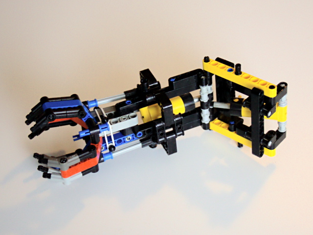

For the claw, I would advice trying to build it using one of those technic motors and controlling them with the HT sensor because they're way lighter than the NXT ones so you'll be able to use less gears. Here's a simple one I made a while ago:
