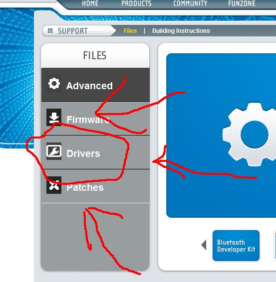

Perhaps you should check that you have the latest Lego Fantom driver, available at
http://us.mindstorms.lego.com/en-us/sup ... river.aspx

Yeah none of this helps. Of course I have bluetooth turned on on the NXT brick and the drivers you linked me to are firmware updates for the brick it says.
